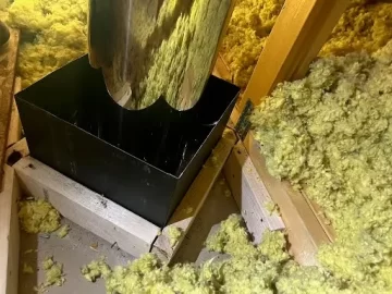

My install guy was terrible. He did so many things wrong, but I have a few questions about some not so obvious things to me.
The attic has blow in insulation. He did not use an attic shield but im wondering if the support box extending into the attic is sufficient enough?
The chimney height is a few inches short of the 2 feet higher than anything within 10 feet. Will a few inches cause it to fail inspection?

While the attic box does provide a barrier, code is code. An attic shield should be installed. The chimney height is of less concern if its only a couple of inches, although you might have the inspector who really black and white goes by the book. Is there a reason why your installer can't rectify the issues? Good luck to you.

Thanks for the reply. Ill go ahead and get a shield ordered. Ill have to try and install myself because I don't trust him anymore at this point.

Had he installed a taller, 24 or 36" square ceiling box, then it would have sufficed, but in this case it's too low to provide full protection. It also should be covered on top. An attic insulation shield will provide this but the chimney pipe will need to be pulled to install. Another option would be to have a sheet metal shop fab up a simple extension that can be pop-riveted on. This would be made with an overlapped edge so that it can be installed opened up with the chimney pipe in place, then the overlapped seam pop riveted. It could have a cap fashioned like this Duratech solution.
