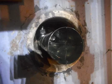

So noted. Before the cement was placed around the boiler exhaust pipe, the chimney tech showed me how the T would slide back, out of the liner. Even without the cement, the liner was over a foot back, so I don't know how I'd get a brush up there. Then, after the cement was dry I asked about removing it - he said I'd have to work at it. I'm thinking I'll hire them to do the cleaning from the top down. I assume they'd then vacuum the T, or remove the T and vacuum the liner?
A photo below before the cement was applied.
You don't ever remove the tee after it's installed like that. I can clean right through a tee like that
That's what I was thinking! I don't know why it was even suggested it can or should be removed.
