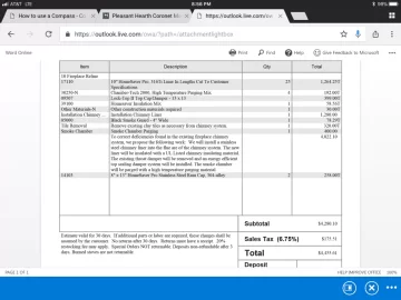

Okay, I just went back through all of my estimates and here is one that I found, this place has estimated a 10 inch liner. My apologies for the confusion, I read the first estimate incorrectly, but the price points were the same for the companies with only about 200 dollars difference.
I gotta raise my prices. :confused:;hm Or move out to Ohio.
What does a service like this cost where you are?
I'm not trying to be evasive but there are way many factors that would disqualify any attempt at quoting a price to reline your fireplace. For all I know he's using an aerial lift to get the liner down the chimney. 25 feet of 10" liner is a lot of material. I think I mentioned on another discussion that relining a fireplace STARTS at 3000 and goes up from there.
