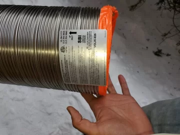

I just learned that guy who did the installation have installed the chimney liner in wrong direction. Attached picture. This end was cut on the top of the roof during installation.
So much for I have been doing this for 40 years.
I called him and he says he will pass monday. I wonder if he is to take it out and reinsert it in the right direction can that potentially damage the liner?
Honestly I regret the decision of buying an insert now.

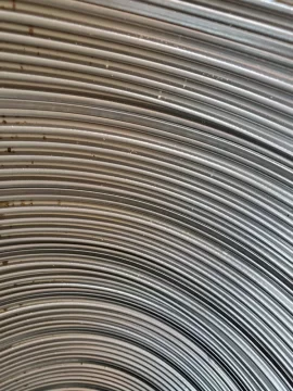

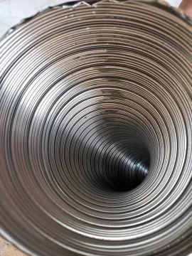

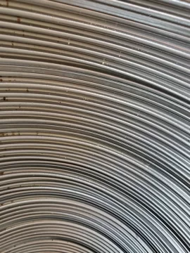

What does the inside of that liner look like?

Direction doesn't matter with that type of liner. It does with most other types though

Well the instructions say it is directional so even though it doesn't matter with that type of construction it needs to be installed according to their instructions so he should switch it
it's for sure is directional. If you look at the locks you will realize how it is directional. I am guessing the lock direction maters due to expansion and contraction of the liner because of the heat, which can explain why creosote can spill through because of wrong direction. But I am not so sure.

I have been doing this a long time and worked with all the different types of liners. Functionality direction of your liner makes absolutely no difference. But because the instructions say it needs to be installed in one orientation it should be.
Can switching be done without damaging the liner?
It should be able to be done. If he got it in without damaging it he should be able to get it out. Is it insulated?
