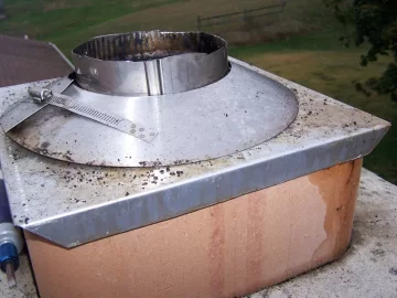

Just got off the phone with my install guy and he confirmed my suspicion: My 6" stainless liner is suspended inside the chimney by nothing more than the two screws securing the cap. The heads of the screws rest on top of the storm collar and the storm collar rests atop the chimney.
Is this normal? C'MON MAN !!!!
note: i have a combo of about 8' of rigid at the top connected to another couple of feet of flex at the bottom. we had to do it that way because my flue has sort of a dog leg at the bottom. so i'm worried about the liner dropping. even if it only drops, say, a foot, it might be enough for the weight of the rigid to come down on the flex portion the wrong way and crimp it.

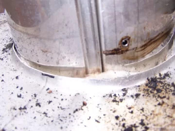

Here's pics with the cap already removed.

Maybe I'm fuzzy on terminology. Let me make sure:
The top plate is obvious, right? And the flue is easy. But is that collar with the band clamp fastener the storm collar or the locking band that you referred to, or are we talking about the same thing?
Either way, on my install you apparently crank down on the band clamp which tightens the storm collar/locking band and then there's one single self-tapping screw that goes into the side of the flue above the sc/lb that keeps the flue from dropping.
Really? One screw keeps it up? I guess two would be better but I just figured it'd be more than screw heads holding the flue up. (And yeah- it wouldn't drop that much anyway, but like I said before, I'm worried that the weight would fall on the flex portion at the bottom and squish it against the inside of my goofy chimney flue)

craig- your top plate looks to be one piece along with the top section of pipe. As you can see my guy just cut a hole in the top plate and shoved the liner thruogh.
holiday- that's exactly what I was thinking.
Think I'm just gonna throw two more, larger diameter screws in the flue and crank down on my storm collar, and call it a day.
