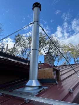

I did exactly that -- made a wedge to give me enough height to easily access the last joint (pic below). I added some traction tape to the top to avoid sliding off the thing. I can easily lift this wedge on/off the roof.
I tried to wrestle the chimney sections apart once just to see how hard it was likely to be, and it's pretty tricky already, even without a burn season. These Duratech pipes kind of snap together when you rotate them and they don't want to disengage without a fair amount of twisting and wriggling. I think the ratchet straps, plus the wedge I built to stand on, will make this job a lot easier.

And the metal roof complicates traction…similar to my roof! Might I suggest you get an assistant to either hold the lever or twist the pipe, I can see potential fall with you trying to do both. Good luck and most importantly be safe!
Reactions: stoveliker
Yes, I’m hoping that I will have an assistant (= son) when this has to happen next spring. I did glue some traction material to the feet of the wedge to help keep it from sliding. Also, the front of it is resting against a snow guard that sits just above the chimney flashing.
