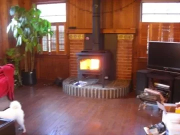

There's a pic of the old one before I took it out...
And a pic of the newly installed stove!
I went with a whole new chimney of Supervent piping from Menards...
