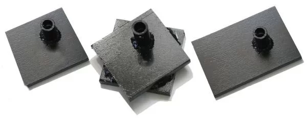

Actually I have a special tool for that. It's a metal plate which attaches to the end of my button-lock rods. You attach a drill and it bashes the snot out of the tiles.
Here are pics of tile breakers. Not much to make your own.

thanks everyone, BB I am right with you. I bought a chunk of steel and some 3/8 inch rebar to make my own. I'll report on my progress. The breaker bar still sits at the bottom. I'm going to crawl on the roof tonight with the trusty head lamp and see where it is resting. Pretty sure it is on the smoke shelf. I like the rare earth magnet idea, but it's a 20 pound bar. I have a pile of small re magnets that I use to hold down hatches on my strip kayak. I'd need to get a lot more!
