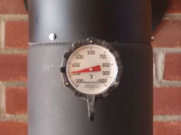

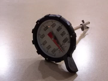

  9. charly
    charly
    Guest 2.
    I have double wall pipe on both my stoves and this probe on both, They stay in one position all the time. You drill a 1/4 inch hole , mount the clip that comes with the probe into the whole, then the probe slides into the clip for a nice interference fit. Probe is a Tempoint, it used as part of an oil burner test kit. Can be calibrated by putting the probe in boiling water and checking the reading, then adjust as needed, comes with instructions. I like it because it's accurate, and it's easy to see form across the room at a quick glance. They go for around 100 dollars at most places, put here's the cheapest I found.
