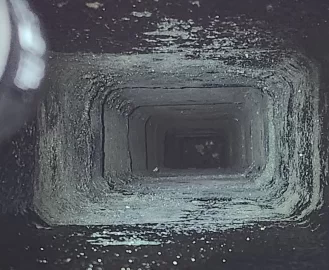

We had a chimney sweep come out and they gave an inspection with the cleaning. Long story short, they recommended we not use the chimney until it's repaired. The repair suggested was for them to install a custom chimney liner. Their logic sounded rational however a few of my neighbors are saying that if we are strapped for cash, the current chimney is not in that bad of shape.
I will attach the picture they failed it on and a picture I took with my phone from the roof aiming down the chimney. The chimney is a 6 x10 terracotta liner but it's a very tight 6 inches, more like 5 7/8" so I don't think I can run my own liner from a big box store kit.

Couple things- looks like there are some gaps in the clay liner you have. That and looks like some glazed creosote in some of the clay.
Their recommendations for a stainless liner makes sense. But- just make sure the creosote is gone before they install new liner. They should do that but make sure they do. Also, make sure new liner is insulated.
Another option is to remove the clay liner (may not be enough room to install insulated liner- and that would take care of the creosote issue.
Ok, so we have a cracked liner and possibly missing mortar in what looks like chimney that had a lot of creosote seeping into the cracks and crevices.
What’s the worst that can happen?
I’m not sure I’d want to chance what a chimney fire would do with my family in the house.
If the goal is to use this for a wood stove, then an oval liner is one option. Another is to bust out the tiles to fit a 6" round liner.
Honestly those tiles are glazed bad enough and have enough gaps I would want to remove them regardless

What you have is definitely bad I would not burn through that if it was my house
