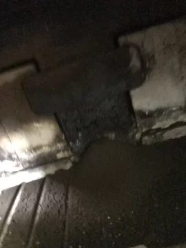

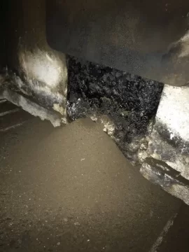

[Hearth.com] Chimney swept- the results [Hearth.com] Chimney swept- the results used the sooteater on my 15 ft of insulated liner. A couple of cups of coffee-like soot with a bit of shiny flakes from way up top. I was pleased overall. Maybe about 3.5 cords burned last season.
Can't tell what we are looking at. But if you only had few cups of chips, you did good. The chimney can be black, but not much but some soot. I get some small chips but no gooey stuff.
The pile in the pic is 99% brown soot. Very little of the pile was shiny little bits ( probably not even a handful).
You're living right and burning well.
Thanks all for the feedback. I experimented with much lower temp burns late in the season. This caused a layer of glaze inside stove as seen in the pic above. Is it ok to leave this glaze until this coming burning season or will this cause excessive corrosion to stove insides?
