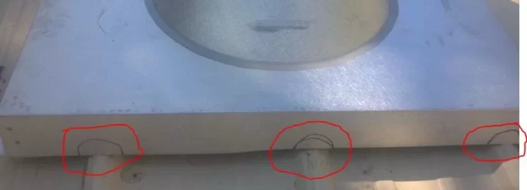

    I did. After I notched out the bottom of the flashing, screwed it down, and caulked it. I'm not sure it's totally necessary since this flashing isn't ventilated, but it is an extra measure of protection.

    This has nothing to do with ventilation. A storm collar that is silicone sealed on the top rim is essential. Without it you will see leaks.

    Where did you notch the flashing at? And why?
    Storm collars are standard procedure.
    Without them, as pointed out, you are very vulnerable to leaks.
    And the collar must be caulked with good caulk where it meets around the pipe.

    I'm guessing he meant here:
