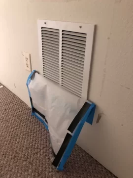

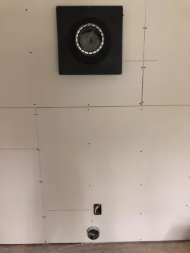

Pics below to show the fresh air intake and pipe to the flue and also we installed a fresh air intake for our hvac system just down the hallway from the wood stove to help circulate the air throughout the burning season. Plan to just run the fan on the hvac system to move the air.
Feel the delay was a blessing as I was able to stalk every forum out there for ideas. May not be perfect but I feel good about this setup.
