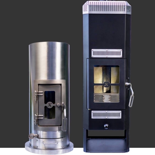

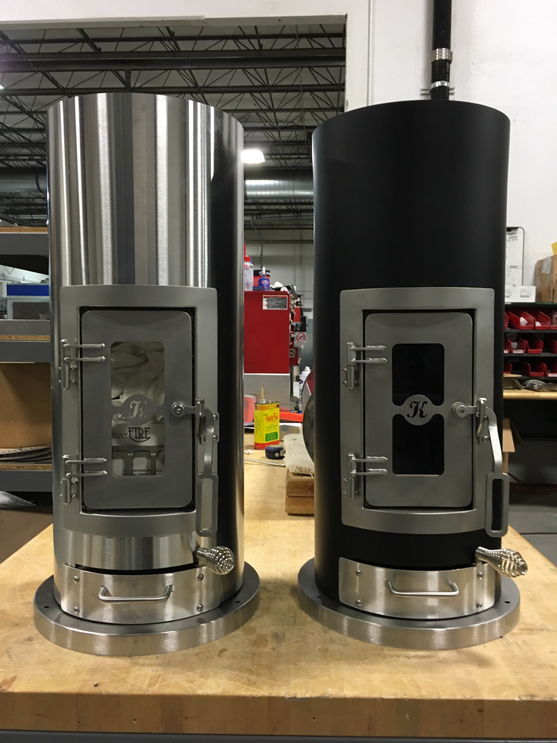

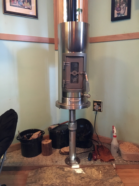

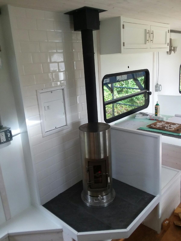

Hi,
Check out this website for a suggestion for a good woodstove. They use significantly less wood than a traditional one and are small enough to also be used in applications such as a boat, tiny home or RV.
The BTU output of the Kimberly is 40, and the Katydid produces 55.

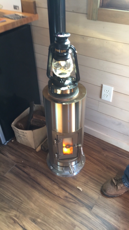

They both also generate electricity - see the photo below with the lantern - via thermo-electric generation. You can also cook on them. Great if you lose electricity or want to live off grid!
Unforgettablefirellc.com
And the you tube channel (some really neat stuff!):
These are great wood stoves, easy to install, maintain and clean (no need to get on your roof!).
