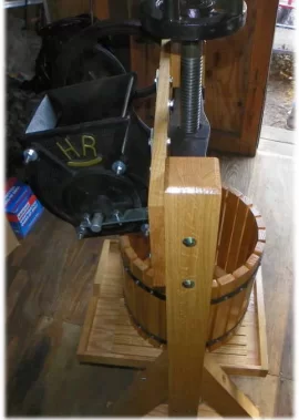

    Here is one we built last winter. We bought the hopper and screw wheel, etc so just had to cut out all the wood. It turned out to be quite a task but turned out really well. Now if we only had some apples! Bumper crop last year; none this year.
    EDIT: We purchased the parts from Happy Valley.

    Actually hydraulics might prove to be slower. As for ease, the screw system is very easy to use. All one needs to do is use a wood handle on the top as you get lower into the pulp and it screws harder. Very simple and effective.
