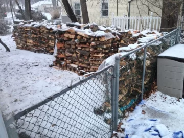

Here is my pile today after processing a small amount I scored on Craigslist:

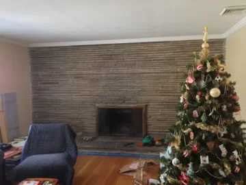

My house is vintage 1957 and apparently has a good sized fireplace:

A contemporary insert would look better here IMO. Something like the Heartstone Clydesdale, Osburn Matrix, would visually fit the style of the house better. A Blaze King Torino (gas insert) would also look pretty good there. But it sounds like you want engineering performance in a wood stove, so perhaps this whole discussion is somewhat moot? Get the BKP and tell her you got a stove named after her.
