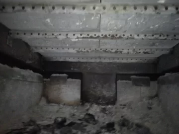

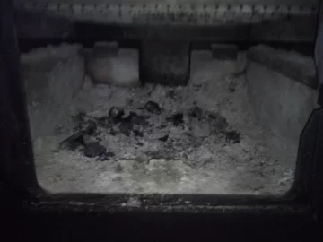

If the price is right it looks like it's in decent inside condition. How is the outside? Englander owners can help you locate some ceramic board of the right spec on eBay. If the pipe is not Selkirk it probably won't be compatible, but it can be sold if not.
It's just the stovepipe.
The top on the lower step looks like it's had a bit of a boilover. Not sure.
I'm waiting for another pic on that.
He had it listed about 3 weeks ago for 650, but within the last couple days dropped it to 600.
Aren't they going for new at the price up somewhere near you?
Offer him $500.00 cash and he'll take it.
