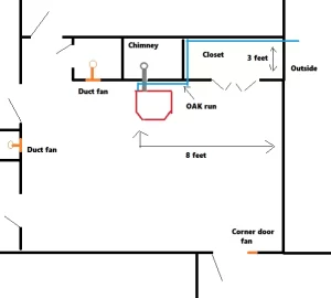

Thank you but I think I may have to pass on that. My stove is about 8 feet from the outside wall with a closet doorway between both. I believe the only other way to run an OAK is to drill a large hole though my floor to take air from my drafty basement ( old granite stone foundation) But I am very hesitant to do that though antique barn wood floors.
Now that I gave it some thought, installing an OAK is possible for me but the run would be long and tough undertaking to drill 2 - 3" holes though 2 walls.
[Hearth.com] Classic Bay 1200 smoke issue, Please help
Can't go straight out back of chimney? Or even up chimney?
