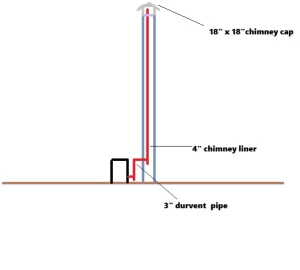

This is my exhaust set up...
Should have plenty of natural draft. What is strange is that you said it has ran fine before now. If it hadn't, I would say maybe too much draft since you can cover oak outlet and it runs fine.

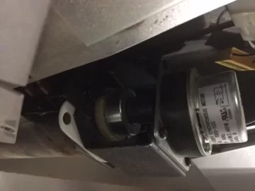

When I took off my auger yesterday the rubber like gasket looked solid behind the auger mount but the Nylon bearing I couldn't tell if it was good or bad.

Well it ran fine last year when I had it in a different location and exhaust arrangement.
I am guessing different exhaust setup then, and would try dumping pot a few more times a day and see how it does since covering the oak return is helping. But I would try and let some thru to see how it does, so it doesn't try and draw it all from other areas of the stove. kap

I think at this point I will just order the auger gasket and nylon bearing to see if it makes a difference since they don't cost much.
I think it is burning clean cause you have such draft with that setup for some reason. Helps when it is burning, but not for fire up. kap

Your vent system raises red flags for me but I'll stay silent for now.

What happens with a nice tall slice of cold air in a flue with enough restrictions at the bottom for a little tiny combustion blower which may or may not be running on high at start up to over come, same thing happens with a down sloping horizontal run, or in a choked down vent.?
Once the cold air gets evicted and replaced with some warm stuff the draft is up to snuff.
True that. But the issue is the over abundance of smoke at start up from a smoldering start up. I'm not there to see the smoke, but it shouldn't smoke that much, on start up, even with his exhaust configuration, esp. with him choking off the oak opening, unless something else is amiss. My question on his exhaust setup is does the 4" go thru the cap, or is he just stopping short of it and hoping it will draft ?
The smoke can't get out the vent which is where it should go, if there is an over abundance of smoke it is simply due to the smoke not exiting as soon as it would which is frequently the only reason someone notices the smoke produced at start up. The smoldering is because the draft isn't there soon enough and therefore impeding the air flow past the ingnitor causing a slow ignition, it is all for the same reason.

This too is possible, but not being there to see for sure leaves it all hanging also. There is smoke, and then there is smoke. Only sure thing is his exhaust is the only thing different to cause this. Does remind me of my wood furnace years back. Had a new chimney installed, square block with tile liner. The guy put some flat block near bottom to narrow tile opening. He thought this would create more draft. It didn't and he had to come back and remove them. kap

Only thing I'm concerned about is smoke coming out the auger shaft. That can be dangerous. And the only thing sealing the hopper on most any pellet eater is the pellets in the auger shaft. lol Bixby used a ferris wheel feeder that had a leather flap over the opening. Next issue is whether he can fix his system, or has to go to something totally different, or live with it.. I have a Sante Fe that has exhaust straight out the wall. I have had rolling smoke in it, and it was caused by a dirty pot, too much fuel, slow start due to too lean a mix. And I am not doubting your knowledge of exhaust systems. Just trying to cover all the bases. kap
Replace the bushing/bearing but unless those are really close tolerance replacements and even then there will be the chance they will leak, the only thing that keeps most smoke from showing up is the air pressure difference which is supposed to be such that it makes the smoke go up flue, even a dirty stove with a warm flue is enough to draw the smoke up the flue unless there is a negative air situation in the vicinity of the stove, in this case it can and will exit air washes, hoppers, and the augur assemblies That was the reason I wanted to know the from and too.
