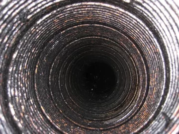

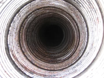

Here are some before and after photos:
[Hearth.com] Cleaned flue with Sooteater system today
Before
After

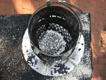

And here is the rain cap before I took it down and cleaned it with a wire brush. As you can see from the photos I did not have much to clean. My chimney is around 17' tall, so I used all six of the three foot long rods. I have easy access to my roof and chimney, so I cleaned from the top down.

Instead of fighting the cap I decided to just dip the creosote and soot ash out from the bottom of the T
from inside the stove. I used a small cup and lifted it into a trash bag I set on top of the baffle. I had an easy reach and this worked well. Once I had scooped as much as possible I finished up using a vacuum cleaner that has washable filters.
I was a bit surprised that I got as much creosote/ash as I did. I estimate about four cups came out of the 17' tall flue. I had burned well seasoned wood, but while I was getting to know my new stove I probably didn't burn some fires as hot as I should have. The Sooteater worked great and I'd recommend it to anyone who is cleaning SS liners. I did not try using it from the bottom up, so I can't comment on how it works in that direction. I got it online for about $43, which was less expensive than just buying fiberglass rods for a brush.
Umm ....That's rusting pretty bad
That's not rust you're seeing the photos, rather it is a thin coating of creosote/ash stain that gives it that orange coloring. The liner is an Olympia SS liner.

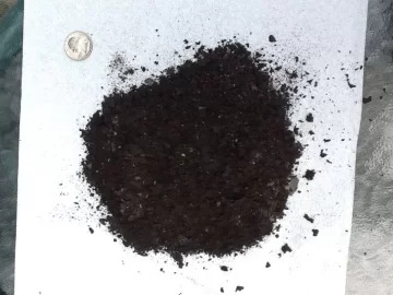

Glad you posted this, Nick. I got mine yesterday and cleaned the flue today. Just had enough rod to make it to the cap. Did mine from the bottom up. Used an 18v cordless drill and it worked perfectly. Also installed my flue thermometer today. Had it since this past winter.
Had to use a mirror to see up the flue, and the Sooteater got all the nasty stuff off and there is only a thin coating of dust from the creosote left on it. Hard to take a pic of it from the bottom.
Here's what I got out of the flue. I had been burning from the end of December thru the end of May.
