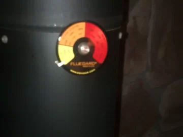

First and foremost , dry wood is essential . Maple , ash , cherry, beech , hop horn beam is what I burn . Moisture content between 16% and 20 %. You need a moisture meter , probe thermometer , surface thermometer or infra red thermometer (harbor freight model works fine)
This is my procedure for start up or reload to setting the draft for a long burn . Draft is set wide open until fire starts to get hot , at about the change of the probe thermometer into the third color (yellow to orange to red), I start to back the draft down about a third , after about 15 -20 min the temp is still up getting into the red , back it down another third , 15-20 min later , I'll move the draft all the way closed. Its not totally closed , but its as far closed as you can get it.
As far as to how much wood I'll put in , it all depends on the outside temps . I find that its better to load fewer splits and burn hotter ,rather than trying to damp down a fire for longer than an 8 hr burn . I like to refill when i get up , get home after work and before bed time. About every 8 hrs , after about 4 hrs you have just coal and a warm Mansfield , I find no need to add wood unless is very cold and windy.
