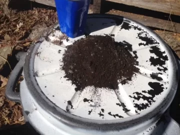

Been looking at pics of creosote for years and figured I would post one. Just once. 21' foot un-insulated liner. 3 1/2 cord burned. Brown powder. Since I usually don't pay much attention to what comes out of the thing I decided to measure it this time. 3 3/4 cups.

Thanks for the post BB. This just goes to show newbies such as myself how important it is to clean your flue and that a seasoned wood-burner, burning seasoned wood still has to do it too.
If that was all i got with a yearly cleaning i would go 2 years for sure.

Yeah isn't that like almost nothing? Especially the brown powder type.
The recommendation by csia is clean at 1/8" of buildup. Under that i don't clean a chimney i just charge them for an evaluation and say see you next year

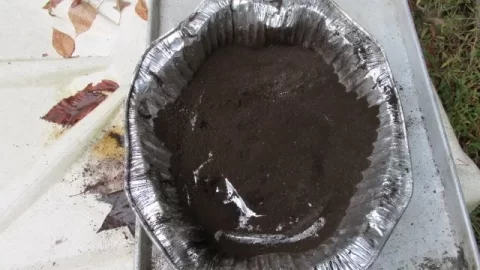

Cleaned liner today. 22 feet, top half insulated. Burn season was late Nov-late March 24/7.
Measured what came out less than 2.5 cup.

Did my pre-season cleanup too. Was about 16 oz of light brown soot. Used to get more of the shiny black crunchy variety but things improved with the block-off plate and re-insulation job I did.
