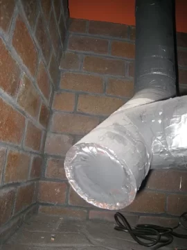

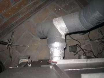

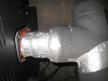

I used silicone and tape to seal the bottom of the T so that it wouldn't smoke. Here are some pics.
IMG_2453 shows how it's connected to the rear of the stove. Basically any joint on the T leaked, so I sealed the joints with silicone and used the tape which I then spray painted black. My concern is that if I have to do this every year, and I can't get all of the tape off, I will end up with a really lumpy looking T after a few years.

That looks like you either don't have an appliance adapter, or something
funky going on there where the stove/adapter meets the T, which probably
accounts for some of your leakage. If you sealed up the cap with
silicone good luck removing it without butchering it and the T.

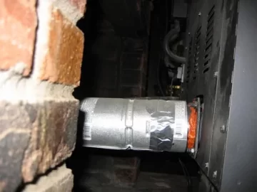

Here's a pic of the pipe to appliance adapter to stove on my st croix btw.
