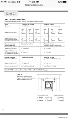

Im kind of confused on the clearance listings for my stove. If I'm reading this right it says using single wall pipe my rear clearence for the stove and the pipe with an unprotected surface can be 11". Is this correct? I was under the impression all single wall had to be 18". Thanks!
You are correct. The manual lists the tested clearance for the stove. In this case however, the stove pipe's 18" clearance requirement will supercede the stove requirement.
