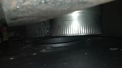

Today I ran my flex pipe down my old chimney, got it through the old damper, lugged my insert inside, got it on the hearth, pushed it back into the hole, hooked it up. Then the disappointment.
I quickly noticed that I would not be able to pull the insert out enough to fit the surround on and then smush it against the brick. My flex liner hits the top inside of the fireplace opening when i move the stove out. The old fireplace is like a metal lined box and the metal runs along the top of the opening which I assume acts like a header and bricks sit on that.
Any Ideas?
I was thinking of an offset adaptor, but I need something that will offset from front to back not side to side.
I realize this is probably a terrible explanation, but I cant think of how to explain it.
Any Ideas?
