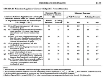

here's the table on the materials listed in NFPA 211
Edit: sorry if it's a little small
