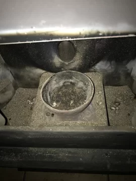

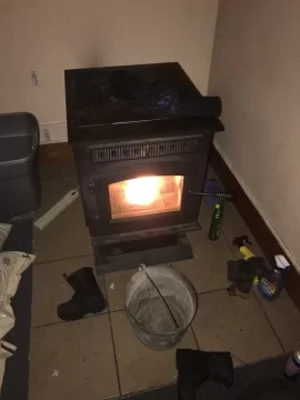

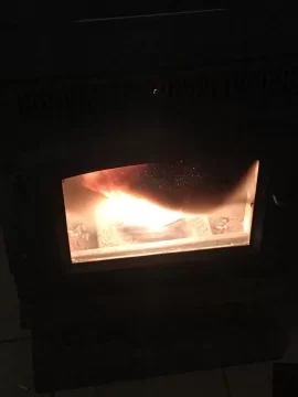

good evening everyone; I have a 4 year old timber wolf pellet stove that seems to be running kinda lazy incomplete. At least two or three times a day I have to shut down and empty the pot because there’s a clinker in it and the glass is blacked out. The pot doesn’t actually over flow. I have pictures of the brand I’m burning the glass and what the pot looks like after shut down. I vacuum every 3-4 days and cleaned the vent well before the first fire. Auger speed is on low and I don’t know what th blower is because it’s a set screw.

Thats a pretty big fire! Have you cleaned the inside of the stove? How is it vented? Dry creek around my area are one of the worst brands I’ve had, more sand/silica, thats what causes clinkers. Give your stove a good cleaning and try some other pellets.

It’s vented straight out of the wall. I had this problem with New England brand as well. Tomorrow is one of the normal cleaning days for it so I will vacuum everything out and try to clean around the blower and stuff again maybe there’s some dog hair in there blocking air flow it was running fine at the beginning of the season

It needs more air then. Your pic shows black soot on the glass thats a byproduct of a slow lazy fire. You want that fire to be busy and a nice yellow and orange. Not a blow torch

Ok fair enough, how do I get more air flow? My stove has a feed rate adjustment and a blower trim set screw on the control board. The flame is like that on the high setting

This the stove on a low blower setting
