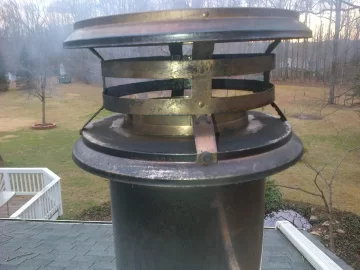

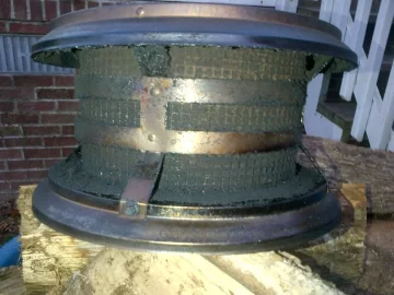

I have a Quadrafire Isle Royale with a 12 foot chimney. After less than 10 weeks of burning, the chimney cap completely clogged. It was 100% clean prior to the burning season (I cleaned it myself). I've never had an issue through 7 seasons of burning. I have been burning a lot more poplar than I have in the past. Could this be the issue? Once that cap was off, wow! The stove took off and started heating properly again!

I don't think any species of wood should do that if it seasoned. I'm guessing the screen would be the first thing to start clogging up though. I know having a screen on the cap is required by code in some areas. How was the rest of the chimney?
Poplar is like willow, it holds a lot of moisture. It needs thorough drying. Sounds like the issue is not the wood species but lack of full seasoning.
Good for you on solving the issue and thanks for posting the pictures. That's a classic clogged cap. If you need to burn this wood, expect to clean much more frequently than usual.
That cap looks pretty bad, I hope you also cleaned the chimney as it seems like it would also have a lot of buildup.
One thing, that cap looks like a Simson brand, the same as what I have, only the screen looks a lot smaller than the one that came with mine, (1/2" vs /1/4"). You could try changing the screen to a larger mesh size.

Your problem is the screen in the cap. Remove it and your problem will disappear. It's not just that the mesh is fine, though it really is quite fine, but a mesh is meant to filter and it is filtering your smoke. I removed mine long ago after repeated plugging with brown crunchy stuff even though the rest of the flue was very clean.
Often a topic of discussion, some people never get any accumulation on their screens and some get it so badly that we remove the screen. Look around at your neighbor's brick chimneys, you don't need a screen and without a screen your draft will improve.

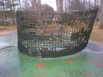

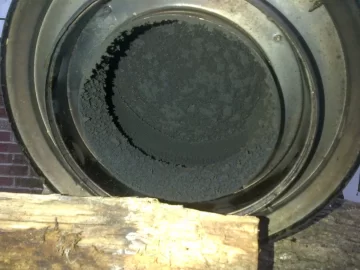

After cleaning the chimney and cap last spring, birds began to use the cap as a nest. They were able to manipulate their way into and through the stainless steel strapping. The cap had not originally come with any type of screen. The third picture in this post shows what it originally looked like. While removing the screen this afternoon, it dawned on me that I had added the screen after the birds became a problem. It never occurred to me that I should consider the size of the screen. The first picture is of the screen I added last spring and subsequently removed today. The second picture is of our second chimney cap and the screen that came with it. It's obviously a larger screen and I have not had issues. Lesson learned. Size does matter...........

Good on you! Thought that screen was on the small side. Here's hoping everything returns to normal for you.
Keep an eye on it, you should get more time between cloggings with the larger filter. Ever since the days of clogging screens I have monitored the cap from the ground.
