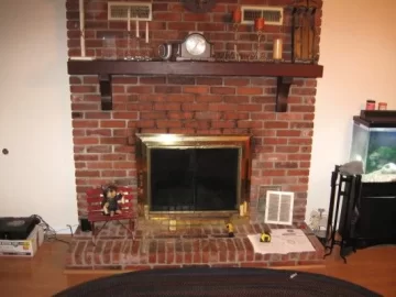

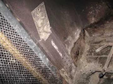

Hello all. Have been reading here for some time and after seeing my brother's new insert and news of tax break I've decided to install insert. My original notion was the Clydesdale, after having my sweep out to check the chimney, he said stay away from soapstone stoves. He also said I didn't need a liner as chimney is in good shape, and didn't need cleaning. The current set up is a steel firebox in fulll masonry surround, ~20' chimney. The fireplace is (after searching to the end of the internet) what was originally a "Brickolator" or heatilator for those that want to debate-I'm need to load software from new camera for pics. I went to local dealer and checked out Lopi Revere stove and started to go ahead with install, -Note dealer confirred with sweep and said don't install liner- i.e directvent. After reading several articles I plan on putting liner in myself. The Lopi won't fit, extension onto hearth violates 16" hearth code. I returned to Clydesdale and now I have conundrum of sorts. The lower vents from brickolator are loser clearances than the Clydesdale surround 48.1". I want this thing to look right, I could deal with partial install and later find some matching brick and close off lower openings. Does the Clydesdale come with a narrower surround?

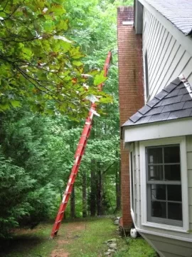

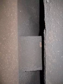

OK got some pics loaded. My ladder was long enough when I resided the house, wont reach top of chimney so flue size is still in question. Caught a short break in the rain...-Forecast for your days off 30% chance of rain, 100% at my house. How do you put pics in the thread? I was only able to make them attachments.
