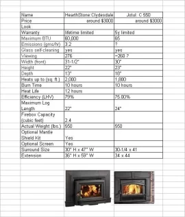

Most likely you will get an answer that both Clydesdale and Jotul 550 are great inserts.
I am attaching a comparison between these two inserts that I created during my search for a wood insert.
The Clydesdale has won over Jotul 550 because of installation flexibility (depth adjusting surround) and a better fit into our fireplace opening.
Two additional hours of heat life is a big plus too.
