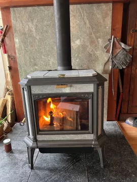

They didn't give me a cat probe. The sweep/installer said they aren't including them anymore because they had to do a lot of support as people freaked out when the numbers were so high. But also they are backordered. IDK, maybe I'll try to order from condor? Wish I had the cat probe for sure.

Awesome looking setup, congratulations!

Don't see one for this stove on the condar site. Also the installer didn't know exactly where the cat probe would go in. So if anyone here has any info on cat probes. I guess I'll ask woodstock.
