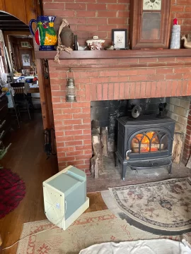

Here is my set up Air filter fan sucks cold air from adjacent room and blows it on slow under the woodstove. Hot air flows thru this room and out to the rest of the house to replace the cold floor air it is drawing in.

This air filter is noisy even on low but this room is dusty with the dogs so i sometimes put up with it. A small fan works just as well and i do use that often instead of the air filter. In this set up it greatly increases the heat in both this room and the rest of the house.

I second the blowing cold air on low speed towards the stove. It'll be replaced by warmer air flowing back. Blow too hard and cold and warm air mix, and it won't move much.
Even a small (4"x4") computer fan (they are notoriously quiet!) on the ground in a door opening works. You need a consistent small flow, then in a few hours you'll see a difference in temperature.
So not a "cold there, switch on the fan"-approach, but a consistent blowing.
