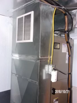

As I sit here thinking more and more , I had to go down to look at the stove over and over....
We have a heat pump with Central AC / hot air registers (outside pump, inside air-handler). We've had it for 6 years. Been burning wood for 4.
Then BOOM it hits me... Last summer we had troubles with the AC not running up to par. The service people came out and had to replace the condenser and found a leak in the coils which led to a loss of "freon" (or whatever it is now). They got to system runningbut the tech said he would like to see MORE cold air on the RETURN side of the ducts.
He CUT A 16 x 16 inch HOLE IN THE SIDE OF THE AIR HANDLER RETURN LINE/DUCT. Well, the airhandler sits 6 feet away from the wood stove. BINGO!
So, I deduce that the furnace air-handler was strong enough to suck the fumes right out of the stove box VIA the air intake ports??.. And then distribute the poison air throughout the house via the duct work.
Anybody agree that's possible???

Well, for one that is against mechanical code. The return air needs to be at least 10ft away from the stove. It would be better to duct it upstairs. Your hypothesis is sound. You could try turning the system off for a couple nights and see if the problem repeats or not.

Well, for one, that is against mechanical code. The return air needs to be at least 10ft away from the stove. It would be better to duct it upstairs. Your hypothesis is sound. You could try turning the system off for a couple nights and see if the problem repeats.
The basement has never had ANY return air until they cut that hole this passed summer. And we have never had an issue with CO before.
I actually remember telling the guy I would prefer any additional return air to come from the living quarters instead of the basement because I wanted the humidity reduction to work best when the AC was running. (removing moisture from upstairs). He told me it doesn't matter where the air-handler gets its return air from, it will work the same no matter what. :mad:

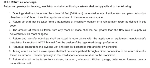

Mechanical code regarding return air. It sounds like there may be more than one violation here.
