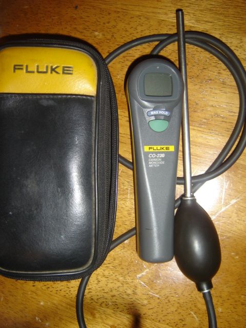

one CO meter and smoke alarm directly above stove ... then one CO meter next to bed for everyone in house. CO meter above stove reads in PPM .. then I've got a Fluke CO meter to double check that.
had really good results from Kidde brand CO meter and Kidde smoke alarms purchased at Sam's. batteries replaced every season whether they need it or not.
advantage of quality Kidde CO meters that read in PPM .. they are easily confirmed working. when stove door is opened and smoke backs up into room during starting fire or what ever. Kidde CO meter will read PPM below alarm trigger threshold. this show meter is accurately reading gas. then those readings can be verified with a professional CO meter like a Fluke CO-220. mine has the optional sniffer bulb
How well do the numbers correlate? I use the alarms that display a CO level, but I don't know how accurate (or slow-reacting) the numbers are.

_CY_, how often do you calibrate the Fluke CO meter? Our meters, PHd4s, PHD4 lite and PHd6s get span caled every 30 days and if we get any readings we cal it again and retest.
