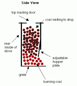

The drawing on the left shows an inside view of a typical hopper-fed coal stove. Coal is loaded into the top of the stove and, once the stove is going well, should be kept full or nearly full. Because of the air flow design only the coal in the lower part of the firebox will burn.When this coal burns completely and turns to ash, new coal will take its place, helped along by your raking/shaking of the grates.
(efel type shown in cutaway. Surdiac and Vermont Castings use a center-fed hopper - operation is similar)
The temperature of these stoves is usually controlled by a thermostat with either a bulb-type or bimetallic element. European Coal Stoves often use a thermobulb connected to a control knob. The dial opens the draft inlet (higher number is more open)- and then when the stove gets hot- the thermobulb closes and opens the inlet to even out the effect of the fire. The bimetal thermostats function in much the same fashion, but not as accurately.
[Hearth.com] COAL - USING HOPPER FED COAL STOVES
Hopper-Fed Cutaway
Fuel and Hopper settings - Most of these stoves are designed to use pea (smaller) coal, which tends to flow onto the grates easier. Inspect your stove for different hopper adjustments and experiment (middle setting is best on most).An exception is the Vermont Castings Vigilant, which uses nut sized. European coal stoves work best with a low-ash coal. Poor fuels will result in shorter burn times and less heat output. Old Company Lehigh brand anthracite coal is known for low ash content.
