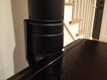

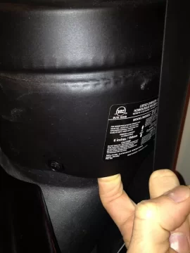

I had a blower door test done and the efficiency expert pointed out that tons of air is coming out where the stove hooks up to the double stove pipe. Where my fingers are in the picture. Is this normal?
I understand that the Selkirk DSP adapter has 1/2" of air space between inner and outer pipes at the bottom to allow for variations in flue sizes but should this air space be continuous with the rest of the chimney? I.e., it's not separated from the rest of the airspace inside of the adapter?

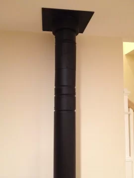

Yes that is supposed to be there that is how double wall pipe works. But i am not sure where the outside air would be getting in. can you show pics of the rest of the setup?
When they did the test it put negative air pressure in the house. Your adapter is leaking air and not sealed to the stove. Mine was so bad I had to use 3/8 door gasket to make the connection. I don't like DSP at all for this and other reasons.
That has nothing to do with single wall or double wall it is either the stove pipe or the collar is the wrong size if you needed 3/8" gasket to make the inner wall fit tight. But honestly stove pipe joints are not sealed and don't need to be so when you put a blower door in you will get some air out of those joints. But in real life it really wont make much of any difference at all

My double wall pipe was leaking in the same spot. I did a smoke test holding a lit match near the flue collar with the stove running and it drew the smoke in. I bought some Rutland door gasket and wrapped it Around and tucked it in. No more leak.

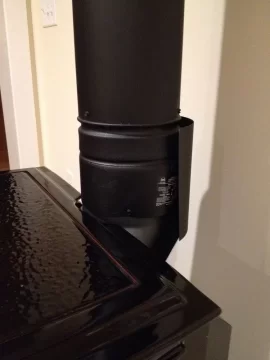

It *looks* correct to me. The ribbed part of the DSP adapter fits inside of the flue output , so I don't think the stove-> DSP is actually leaking.
I think the outer wall of the DSP is allowing cold air seep down
Yes it was most noticeable when we had the blower door test going - but on a windy day I could feel cold air getting pushed down and out the bottom too.
Maybe this is just how it is designed. I'm assuming I should not try to fill the holes with any kind of sealant.
