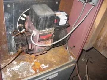

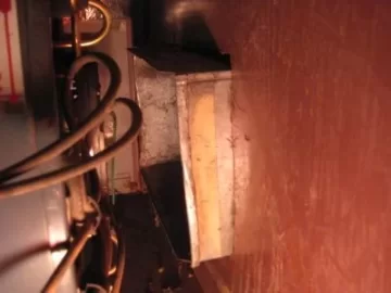

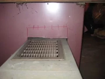

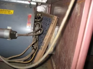

Here are some photos of my furnace and ducts.
As you can see there is a large register in the return duct just before it enters the blower (I think it's the blower). Since there's a register in the duct, aren't the gaps in the duct themselves similar in effect. Will sealing the gaps have any benefit?
How can a system be closed if there are open registers. Don't the registers themselves open the system to outside air?
Regarding the filter, I know, I should figure out a way to attach the filter properly to the duct opening. Can I just put the filter on top of the register?
I bought this house last year and this is my first experience with a forced air system. As always, any suggestions you have would be appreciated.
