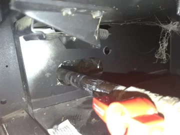

The pipe....ugh. Not sure what these all look like, but imagine the setup is basically the same. Where that gas rigid black pipe comes into the firebox as best as I can tell there was a plate with a knockout. The installer has removed the entire plate to allow the pipe to come in. So instead of there being a small opening around the pipe to seal, there's a gaping hole maybe 2" x 4"....this is where my Cold Air is coming in.
My plan is to get some Rockwool (impervious to heat) and fill the opening with it.

Ok, here's a picture...see, hard rigid gas line incoming that changes over to flex. I expected to find a small hole like the one on the right....not the gaping wind tunnel I that exists.
If this were electrical, this would not be a code-compliant install. I doubt that it is for gas either.

Looking at the photo, it looks like the black pipe is the gas feed from the house. Shutoff valve installed on the end of the black pipe. Then flex pipe to the gas valve. If thats not what it is, then Im pretty sure it wouldnt meet code. I have never seen anyone connect black pipe directly to the gas valve except on water heaters and furnaces where access is usually much better.
I dont understand how the gas connection should be causing any problems unless there is cold air leaking into the chase the fireplace is installed or the direct vent is not properly connected to the stove
The black pipe is the house feed. Shutoff valve, then flex line to the valve.
The air is ripping through the hole where the rigid gas line enters. This can only be from a poorly sealed exterior.

Final update, as the gas line enter outside of the firebox, I used Nashua Aluminum tape with a 200F rating. The temp on the foil after hours of operation (fireplace is fixed) is 112F.
