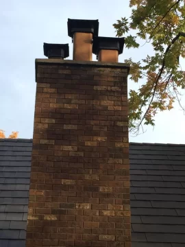

Hello!! We are new owners of a Hearthstone Heritage stove and this will be our first year burning wood. We have a 22 foot masonry chimney and our stove is connected as a rear exit. There is definitely a learning curve here, and trying to learn as we go. Looking for suggestions. Tonight would seem like the perfect night to build a fire, however I just gave up! UGH. Its 34 degrees/super light wind/ light drizzle. It seems like we have a strong reverse draft happening and for the life of me I can't seem to get the draft reversed. I tried lighting a rolled newspaper near the flue and ended up with smoke coming out of the bottom of the stove. Also tried lighting a couple of candles inside the firebox, but couldn't get enough of a draft going that way either. Have noticed also that when its humid or damp our house smells like an indoor campfire, since getting the stove. Any suggestions?

Can you post a picture? This sounds like a tough combo when combined with the 90º turn in the cold chimney. That and the chimney expansion sound like trouble.

  • [Hearth.com] Cold Chimney issues /need advice
