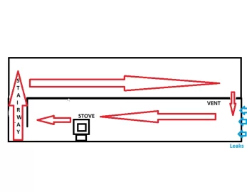

When I burn only the downstairs stove I also get a cold draft at the bottom of the steps leading into the stove room. In my case it is the cool air from upstairs tumbling down the stairs to replace the hot air that is going up via a vent at the other end of the room.

Sealing the basement area could mean that make up air will now come from upstairs exclusively, causing an even bigger draft. I sometimes crack the sliding door in the stove room, and it reduces the cold draft downstairs, and surprisingly, improves the heat flow to the upstairs. Many here say they crack a nearby window. OTOH, I have to sing the praises of rim-joist sealing on my heating bill, and even more on my cooling and dehumification this summer, so I recommend you do that anyway. I think you are just feeling the retuning air that is replacing the warm air going upstairs.
