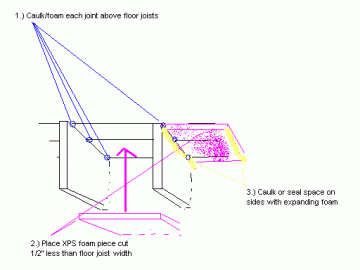

According to my energy books, the right method is to use XPS. Fiberglass would be the worst possible solution, a 1% air space around fiberglass will reduce it's effectiveness 30-50% and under floors it's almost impossible to install it correctly, without air gaps or channels forming.
My energy books say the proper method for crawl spaces is
1.) Caulk or use insulating foam to first seal any air spaces between the plank as they pass through the floor joists & support beams. Caulk is preferred, basically, go down every floor joist and where there's a space between the planks, fill it. You only need to fill the small spot above each floor joist where the planks are seperate.
2.) Once that's done, the best material is XPS that's Extruded PolyStyrene. Probably 2" thick, it's the baby-blue if made by DOW or light pink foam board if made by Owens Corning (foamular is the the same). Best to get the 4' x 8' pieces.
3.) Measure each 8' space looking for the shortest distance. If it's 14 1/2 you want to cut the next piece 14" to leave a 1/4" gap or more on each side. I prefer to cut it with a Skihl saw 1 1/2" deep and snap the rest like dry-wall with a push down until you hear it pop and then a lift up to finish, a table saw can also easily cut it but I find the table saw likes to grab it, or bite pieces out of it and dangerous. Happens everytime with me, meanwhile my father has cut as much as I have on the same table-saw no less and never happens to him.
4.) Fit it in place, tight against the subfloor as possible and shim it so it stays without holding, then take either expanding foam spray and spray it as deep down in the openings on each side (best method but also expensive) or caulk down each side.
Rinse, repeat. If you want to really do the job then...

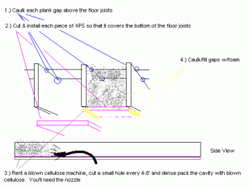

1.) Follow step 1 above
2.) Cut and adhere each piece of XPS so that it completely covers the bottom of the floor joists, probably best to go perpendicular to joists.
3.) Rent a blown cellulose machine, and the wall nozzle attachment
4.) Cut a small opening in the XPS, saving the piece and dense pack the cellulose in the cavity.
5.) Put the piece back that you removed, and caulk it in place so that it keeps an air tight seal.
I included pictures of both methods, in the best possible scenario I didn't draw the XPS perpendicular to the floor joists like I should have. I didn't want to redo the picture.
  • [Hearth.com] Cold floors/crawlspace
Adirondackwoodburner said:
wait a minute. so you are basically saying that I should run foam board insluation parallel to the rock foundation and not tack it up on the underside of the floor??
That saves money & time and is an improvement but isn't as good as tacking it up underside of the floor.
I was thiking about doing the #2 at first. This is becuase I have piping that runs under it and if I ever needed to access it that blown in insulation would be tricky..I wounder if jsut tacking the foam directaly to the subfloor would be ok?? meaning my joists are hand hewn and some span a distance of 4' or more..
I think I tried to show that as option #1 the (easy.gif). If you mean tacking it below the floor joists like my picture #2, but skip the cellulose that will work as well but you really have to make certain you stop air leaks before tacking it in place. That will give a dead-air space which will give a little bit of added insulation, and also prevent short circuiting of the cold through the floor joists. The key will be how well you caulked any possible air leak beforehand and caulked/sealed the XPS afterward. You'd have to make sure there isn't a pathway for air to sneak in around the perimeter and pretty much nullify the insulation. I think it won't be possible to do #2 but skip the cellulose cause it's just too easy to create a wind tunnel.
