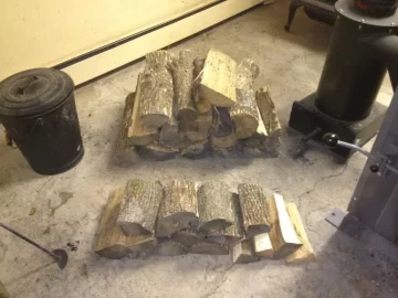

Tonight is suppose to be -10F. I will be loading her up with Ash hardwood only. No soft pine to burn away quickly.
Here is a pick of the wood to go in. The splits and rounds in the back are only 16-17 inches. So I used the chop saw to cut some short ones to go in the front and get full use of her.

Didn't the Beatles have an old song , or at least the lyrics "happiness is a warm gun" ?
Would you like me to send you a tape measure that goes to 26";lol

;lolGood one! Any time I can find a good deal on craiglist and it saves me from having to cut it I take it. This wood was all cut to 16-18 inches. But that's okay. I think it worked out to about $23/face cord, something like that. That was cut and split. I just had to haul it 7 miles home. I will take that all day. How the hell ya doing? How is your wood supply for that Gun holding up? Looks like it is cold up your way as well.

What do you plan to heat with that wood? Let us know how that load works out.

4200 sq.ft. house, 900sq.ft. garage, and domestic hot water. But luckily there is no call for domestic hot water right now! It is -11 with a very slight 1 mph wind. The Wood Gun is running non stop, keeping itself at 178 degrees right now. No heat going to storage. I think she is maxed out! The oil boiler has not kicked on yet though! !!!
