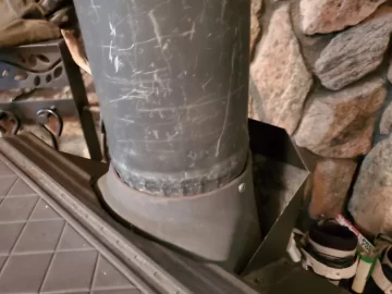

I tried to crimp pipe to squeeze in deeper, it just made gaps worse. I was able to get round again, and it seats too high, so may try the cut bottom edge off next.If you hold a match next to the gap does it suck the flame/smoke in? I'll let the experts chime in but as long as the draft is good, the stove is performing and the flue is under negative pressure do these small gaps matter?
What did you find? Is there a ledge inside the flue collar stopping deeper penetration?not sure if hitting bottom ledge or just too wide in couple spots, will take a look, thanks
The collar has a slight angle towards inside, just enough to keep pipe from sliding in fully. no ledge or obstruction. Do not have ID but collar is standard for jotul f400. besides what I mentioned above to cut pipe, or use some kind of seal, I will also go buy as new pipe and see if fits in better(or return it if not).What did you find? Is there a ledge inside the flue collar stopping deeper penetration?
As noted, recrimping is the opposite way to go. What is the exact ID of the flue collar?

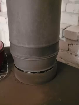

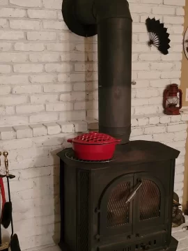

Pictures would helpMy wood stove has a visible gap ( can see the flame) at the junction of the stove opening ( on top) and where the vertical pipe slides in. I've tried high heat stove cement to seal it but it dried up & fell away. I had some door gasket cord left & tried attaching that but could smell it as the pipe/fire got hotter. Was concerned so removed it. Is there a metal collar/fitting/part I can buy that can be wrapped around the pipe to seal this gap. I smell smoke sometimes that I suspect is leaking from there. My pipe heads vertically (about 2') to a 45° bend, then 20" horizontally out through the wall. The damper is inside the vertical 2' pipe and the stove has a metal baffle inside. Stove cement hasn't worked. Willing to purchase a "collar" if it exists. Any help?
Have you tried just a straight uncrimped piece of pipe?
Oversized flue? Not sure what you mean. 🤔 This pipe is not crimped.Have you tried just a straight uncrimped piece of pipe?
The oversized flue is probably contributing to the smoke issues
You increase the size of the pipe at the stove. That means the pipe is to large and probably dumps into an even larger clay liner correct?Oversized flue? Not sure what you mean. 🤔 This pipe is not crimped.
There isn't an adapter. Just the cast iron opening which is part of the stove. The pipe fits into the opening (male to female.) That is where the gap occurs. The wall pipe fits into a clay flue inside a concrete block chimney. I don't believe it's larger than the pipe diameter. Is there such a part as a metal "collar" that would be able to wrap around the connection of the pipe and stove opening, thereby, sealing the gap?You increase the size of the pipe at the stove. That means the pipe is to large and probably dumps into an even larger clay liner correct?
I assumed that adapter was male end down. Because the top is female

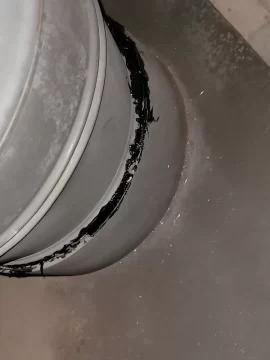

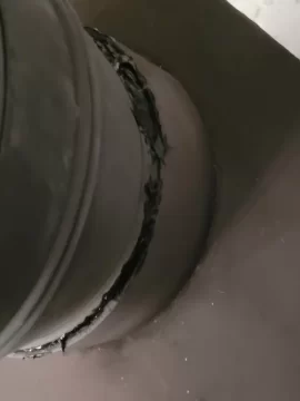

It IS supposed to be high temp(Rutland 500° I believe) but, when I used it before, it eventually crumbled and failed. There IS direct flame visible at the joint so VERY hot. Once I do exact measurements, if this collar will fit OVER the stove opening and the stove pipe INTO it, it MAY finally solve the issue. Thanks. RoseIt will slip into the stove collar as well as over it.
Is that a high heat sealer and if so has it solved your problem?
Is that RTV? If so, the flue collar gets too hot for RTV. It can get much hotter than 500º.It IS supposed to be high temp(Rutland 500° I believe) but, when I used it before, it eventually crumbled and failed. There IS direct flame visible at the joint so VERY hot. Once I do exact measurements, if this collar will fit OVER the stove opening and the stove pipe INTO it, it MAY finally solve the issue. Thanks. Rose
I don't know what RTV is but, clearly, it doesn't hold up so MUCH higher than 500°Is that RTV? If so, the flue collar gets too hot for RTV. It can get much hotter than 500º.
RTV is a high-temperature silicone sealant/adhesive.I don't know what RTV is but, clearly, it doesn't hold up so MUCH higher than 500°
