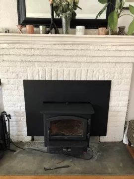

I got a stove installed. It is 30" from the top to the bottom of the wood mantle. Also the face is 10" to the wood floor.
The installer said no worries about being combustible but you would want a hearth extension pad to protect the floor.
I burned last night and the temp of the floor and mantle got to 100 degrees F.
So I am just confirming I do not need a heat shield for the mantle - sound right?

It should be ok once the hearth extension is installed.
What insert is this, the 1750? How is it heating? Can you post a picture of the new installation that includes the mantel?

Thinking about getting this for the pad. I'll get some photos when I get home.

Photos:
