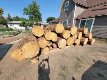

Speaking of which, I had a buddy with logs too big to process on his fully auto firewood processor. I gave him a place to drop them...my driveway! I'm going to buy a bigger bar and chains while in Fairbanks later today.

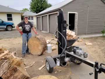

Is bigger better? My back says, nope!
Reactions: Ashful

Is bigger better?
The novelty wears off quickly. For me, it's elbows and shoulders, always sore in the evening after levering big rounds onto the splitter.
A cant hook is a lifesaver, when you get into heavy rounds. Like a second hand, I use it for moving rounds onto the splitter and then for holding them at the desired angle while the wedge comes down.
To the OP, you've got a premium list of stoves, there. begreen's post #8 says a lot, read it twice. I like the thermostatic behavior of the BK's, it gives more constant heat output over the full burn cycle, and lets me do long burns to suit my schedule. But that's just one factor in choosing a stove, and maybe not as important if you're mostly running it hard.
Reactions: BKVP
