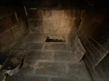

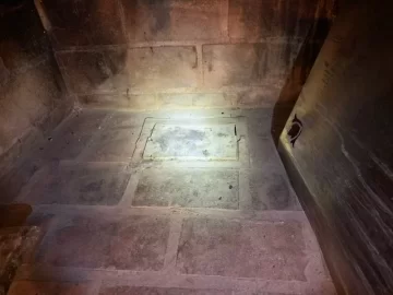

I’ve always been a city guy and only moved to my first house a year ago. Fireplace has been working fine, but I decided to give it a deep clean and found an opening under the piece of metal underneath the insert. It is probably 8x4 inches and has a cover.

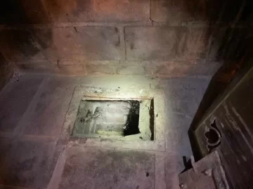

I removed the cover and there is an opening, but it’s not a part of the basement, looks more like a space between the basement and foundation

Is this normal? Does that space or cover need any maintenance? Also, should I keep it closed with the cover as it has been for a year?
thanks and sorry if this is a dumb question.
Yes, ash pit. Leave it covered unless using to dump ash into it.
But getting the ash out is a PITA. Use a shovel and a bucket.
If this is on an external wall there should be a door outside on the chimney to remove the ashes.
Dispose of ashes safely. Don't burn down the county! :eek:
