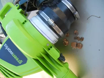

Do a search for 'leaf blower trick"…
Usually after one has brushed and cleaned entire stove and venting. Works great on stoves with false walls and passages that are hard to get to!

Local big box had a sale on the blower/vac and took it to plumbing dept to get adapters. Was around $50
