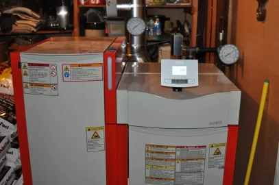

They have a tiny little Windhager decal waaaaay down on the bottom of the door.View attachment 97296

One another note though, back to the OP's topic, here's a picture of the Windhager I am burning as we speak. I think you'll be able to make out the water temperature (right hand gauge @ 176*) and the digital display showing the flue gas temp (195*). The output (firing rate) at the time of the picture was 43% or about 32,000 btu. This is extremely low for a flue gas temp and would cause major issues in a cordwood fired boiler. After running this thing for the last 6-8 weeks I would have a very hard time convincing myself that cordwood was worth the extra time and effort involved in my case.

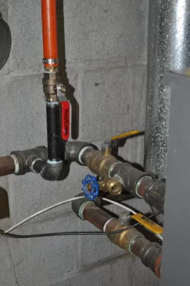

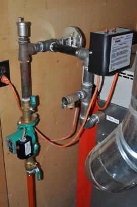

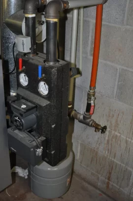

what's your heat distribution system look like? how fast is the modulation and or shutdown?
Just remember the immortal words of Gil Carlson who headed up B&G's tech department for years. "What goes into a tee, must come out of a tee".

Thanks for the pic Heaterman, would like to see one of the other side. I'm talking with marc about installing one here in maine, we need to iron out the piping (installed in parralel with wood boiler) and I need to line my masonry chimney with stainless because of condensation.
Chimney vented with Class A pipe (to eliminate any possibility of corrosion). Windhager wants to see a negative .02-.04 wc" draft on it. The primary reason is to be able to vent any CO if there should be a power outage or the like. This is of course something that is not talked about much by many manufacturers and/or installers but needless to say is a very important consideration. If the boiler shuts down for any reason, whatever reason, where are the combustion gases going to go if they can't vent outside naturally?
