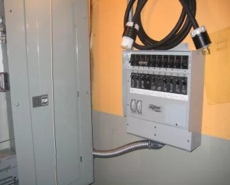

been running strictly pellets for heat past 3 years...
have a good sized generator out back and a transfer box attached to the main panel so we can run 10 circuits
in the event of a power failure....
one of the circuit is the oil furnace in the basement so we can run it along with hard wired rooms and such..
that big ugly chord get's plugged into my genny and other end into 30amp outlet on the porch which runs all the way back to the transfer box.

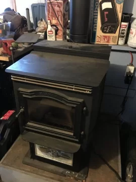

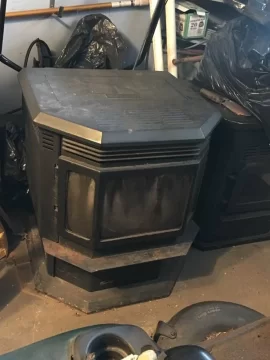

I have a P61a and CB1200 just in my garage right now :). Good stoves! All automatic too!

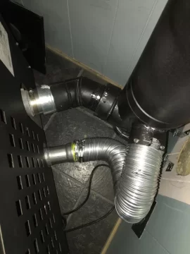

Do not forget the best venting - Selkirk DT for the best stoves! This venting warms and dries the burn air for 10% over all more efficiency!
See pics below
Click to enlarge.
