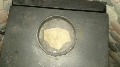

Insulation blanket across top seemed OK but I went ahead and removed it to inspect better and reinstalled. I trimmed the front about an inch to make it not hang over the fiber board at all (it was about 3/4 an inch before). Now it's perfectly aligned and mated at the edge.
I doubt it should be able to do this but just in case that blanket under the flue collar was being sucked up when burning (due to strong draft) I placed a small piece of 1/3 inch thick flat sandstone on the insulation (see pic) that weighs about 1/3 pound. A little smaller than the flue collar opening, about 1 to 1.5" all the way around.
I also checked and its perfectly level from back to front and side to side.

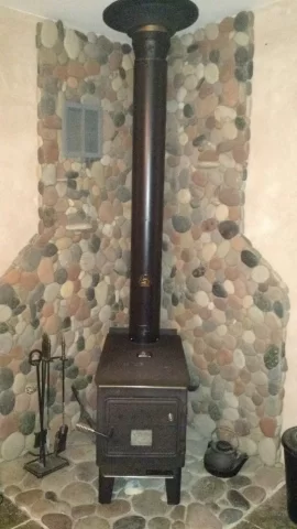

I also attached pic of interior setup. There are 5 joints total. Flue collar, flue collar adapter (2), sliding pipe (1), pipe to ceiling box adaptor (2). They seem tight and I can't here or sense any leaks, but possible I suppose.

I completely removed and trimmed the front piece of insulation. The stone weight was just for added safety. I'm assuming problem was caused by the front insulation being too big, or bunched up.

Sounds like the issue is and has been weak draft due to expanding to 8" chimney and altitude.
What was the previous EPA stove? Some are very particular about minimum draft necessary to pull air though a circuitous secondary air path. Without proper draft secondary burn fails and the stove performs poorly. The Durango may have a simpler more direct secondary intake and manifold that helps it breathe easier.

I just think the insulation was bunched up blocking half the draft. It would burn fine and hot when closed.
